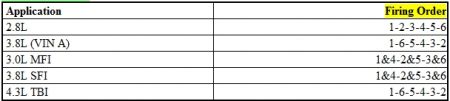

1986 Pontiac Trans Am 6 cyl Two Wheel Drive Manual
firing order

2.8L Engine Clockwise 123456
