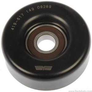

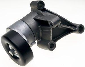

Can just the belt tensioner wheel on my 2000 Sunfire with 2.4L engine be replaced or does the whole tensioner assembly have to be replaced? I suspect the tensioner wheel bearing is running dry on lubricant.

Yes you can replace just the tensioner pulley
its about $10 to $22
this is a picture of the two
https://www.2carpros.com/forum/automotive_pictures/99387_getimage_4.jpg
https://www.2carpros.com/forum/automotive_pictures/99387_getimage1_1.jpg
