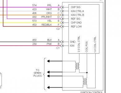

im having a problem trying to start the car. Car cranks doesnt start I check to see if there was any spark, but no. I changed the plugs n wires but still nothing. I also tried to jump start it but also did nothing. My next is is to check the coil packs how would I be able to tell if there still in working condtion? No fuses are bad either.

You have the 2.2 litre engine? You have plug wires? The problem could be several different issues. You have spark at none of the plugs? Engine cranking, you have no injector pulse? If no spark and no injector pulse, I look for an rpm signal, that signal comes from the crank sensor. I can't say the crank sensor is faulty, could be other issues. Any applicable trouble codes? At the least, you need an obd 2 code reader. Even then, the codes, if there are any, may not help?
I wouldn't think both coils would go bad at the same time?

If you use a digital multimeter across battery posts, everything turned off, the generic spec for a full charge is 12.6 volts. If the battery is down get it charged. Engine cranking, the reading across the battery posts, usually, shouldn't drop below 10 volts. Unless you can do a little testing, I'm not sure how to help?
At the ignition module, you can check for voltage and ground, probably a two wire connector, key on, pink wire is voltage, black is ground.

If there is a problem with wiring circuit somewhere, it won't matter what part you replace. I've already told you all I know, I can't go any further. The voltage and ground to the ignition module, pink wire is voltage, goes hot with the key on. Black is ground. Take connector loose, use voltage tester between the two wires. If no voltage, comes from ignition fuse.
https://www.2carpros.com/forum/automotive_pictures/170934_sunfire_ignition_module_2.jpg
