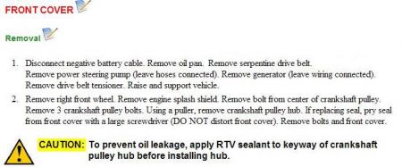

I need to know how to get to the timing chain. What has to come out? Can I print off a free diagram

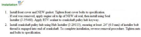

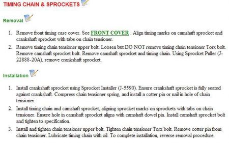

BLUELIGHTNIN6
MECHANIC
16,542 POSTS
+1
Sunday, December 27th, 2009 AT 1:57 PM
