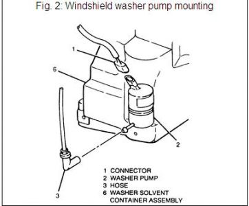

Location of windshield washer pump
Sunday, January 25th, 2009 AT 11:04 AM
JDL
MECHANIC
16,098 POSTS
It should be at the windshield washer reservoir. You can check the wiring circuit. Check also, that the hose isn't clogged.
