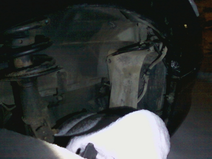

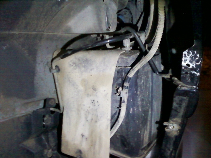

I need to know if this is indeed where the computer is located in my 96 sunfire before I pull it out.
Pictures were taken in the passenger side wheel well after removing the splash gaurd
Also what do I need to do when I put the new/used one in?
Nov 10, 2017 at 12:35 PM (Merged)
WRENCHTECH
  • 20,761 POSTS
No, that is certainly not the computer. That is the fuel vapor canister. It has fuel lines going to it, not wires as the computer would have.
It appears that it's behind the right front bumper which is a pretty unusual place for it to be.
