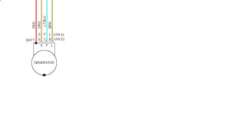

It looks like the alternator isn't charging. Maybe a problem with the wiring circuits to or from the alternator? Do the same test at the alternator bat terminal. Engine off and engine running. Don't get the leads caught in anything. Use a metal part of engine for meter ground. If the second reading, engine running, is higher, there is a problem with the wiring circuit from alternator to battery. If the second reading still isn't higher than the first, you need to check wiring circuit to alternator. I know you said the alternator was good, right?

I'd use a digital multimeter and check voltage at all generator terminals, engine running.
https://www.2carpros.com/forum/automotive_pictures/170934_generator_1.jpg

Ok, I have looked and looked for something with that color 4 wires and I am not finding it. Is there another name for the generator, or tell me what other component it might be by in there, sorry to be a pain, and that it took me so long to get back at ya.

They also call it an alternator. Databases are not always correct. That wiring is what our database showed.

Ok I tested it, I have a question though, is the plug that comes off the alternator supposed to be plugged in somewhere cuz it isn't but I still tested the wires
red- 11.3
orange- 9.5
lt blue-.08
brown- 9.37
I have no idea where to go next please help a girl out?
Shanon
Tuesday, March 16th, 2010 AT 6:10 PM
JDL
  • 16,098 POSTS
One end, plugs into the alternator. If that isn't factory wiring, I'm not sure how to help? If your talking about, the end of wiring harness, away from alternator, yes it should be plugged in.
