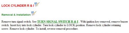

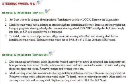

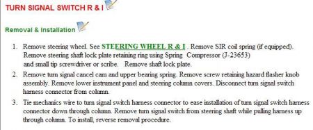

how do I replace my ignition cylinder in my car?
Tuesday, March 2nd, 2010 AT 3:29 PM
BLUELIGHTNIN6
MECHANIC
16,542 POSTS
Tuesday, March 2nd, 2010 AT 3:34 PM
