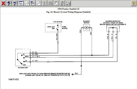

Heater blower stopped working. Also anti lock idiot light on and brake idiot light flashes. I jumped the fan and it works. Where is the blower resistor and how do I check that or what else could it be?

The blower motor resistor is located at center front of dash below wiper motor assembly. At the blower motor resistor you should have battery voltage at the orange wire with the control switch at Hi position and lower voltages on the other switch positions. Also see below

All of these symtoms started at the same time. Any thoughts?
