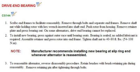

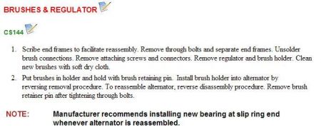

we took off the alternator off the car, and we need to dismantle it, please help because my teacher will yell at us if we dont fix it. Thanksssssss

https://www.2carpros.com/forum/automotive_pictures/261618_Noname_1479.jpg
https://www.2carpros.com/forum/automotive_pictures/261618_Noname2_432.jpg
