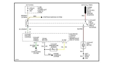

The radfan works but wont come on put a new cooling sensor thermostat and nothing there was a switch on it to turn on off but took it out want to fix it but cant figure it out there are no breaks in the wires so can you help me out

Your problem could be the relay or the computer see how it works below before the fan will come On.
https://images.2carpros.com/forum/automotive_pictures/12900_fan_relay_2.jpg
Courtesy of www.eautorepair.net
