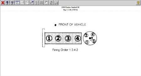

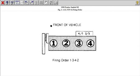

please what is firing order of spark plugs I think ilooking in from left to right 523614 spark plugs frount is 426 from left rear is 531 from left is this correct
