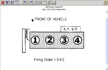

what is the firing order for a 1989 pontiac sunbird gt turbo
Thursday, July 31st, 2008 AT 4:39 PM
MECHANIC
75,992 POSTS
See below
