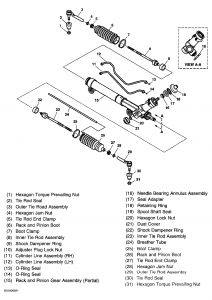

Raise car, put on stands, grasp each tire and push/pull both horizontally and vertically, looking for any movement which would indicate bearing, ball joint, tie rod end or bushing problem. Check rotors and calipers and pads for unusual wear and make sure calipers are torqued properly. If OK, then check that steering rack is securily bolted to frame. Also check PS pump fluid level and contidion of serpentine belt. Check PS pressure and return line for leaks. Check cinch bolt connection to steering rack. Rack:
https://images.2carpros.com/forum/automotive_pictures/108325_rack_2.jpg
