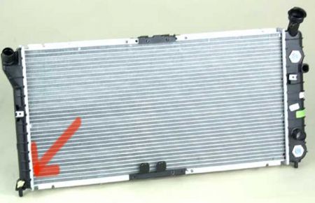

I am trying to flush out radiator but I cannot find the drain plug?

It is on the driver side bottom of the radiator.
It may open with a 1/4" extension. Half turn or so if I remember right. You will have to look. It may be a thumb turn like this after market one is.
