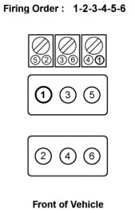

Like to know the firing order for 99 pontaic montana 3.4L
