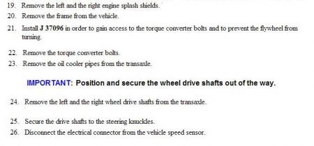

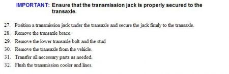

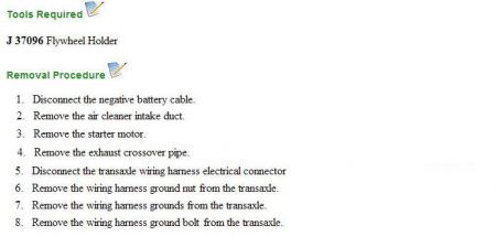

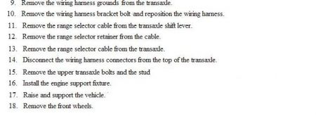

What are the most important steps when replacing the transmission of a Pontiac Grand Prix 2006
Wednesday, February 24th, 2010 AT 12:52 PM
BLUELIGHTNIN6
MECHANIC
16,542 POSTS
+3
Wednesday, February 24th, 2010 AT 1:06 PM
