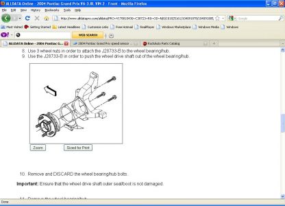

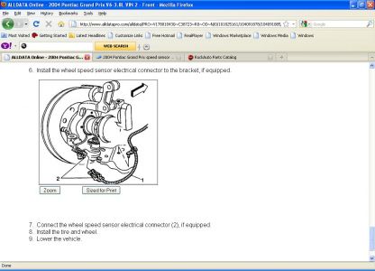

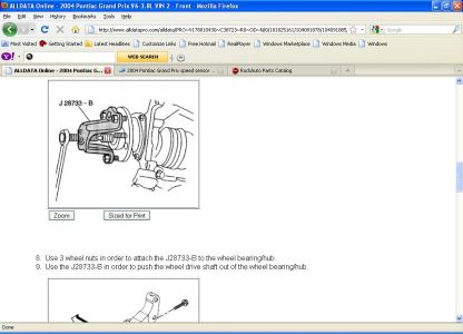

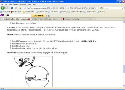

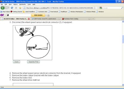

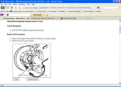

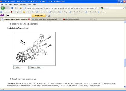

How to peplace left front wheel speed sensor harness

There you go.
