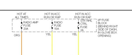

I have a factory installed radio in my car. The display does not always work, so I dont know the time or the radio station. It is starting to work less frequently. Some have said the radio needs to be replaced and others have said it is a wiring issue

You could check fuses. One shows to be hot all the time, the other two go hot with the key on. Not only check the fuse, use a voltage tester at the fuse circuit.
Any applicable codes?
https://www.2carpros.com/forum/automotive_pictures/170934_pontiac_radio_fuses_1.jpg
