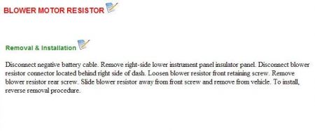

Where exactly is the fan blower resistor located? Also, what do I need to remove/replace it. I already have taken off the cover that is above the passenger foot well area.
Many thanks in advance.
