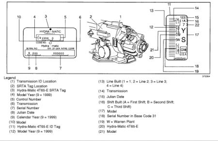

https://www.2carpros.com/forum/automotive_pictures/147643_trans_2.jpg
post back with what you find.

So I would have to find this info on the transmission?
I'm not going to be able to do this, would a mechanic do this? Is there any other way to find the problem?

Before you do anything, these vehicles only came with a 4T65-E trans, the info above fits the problems you describe, the check engine going on and off is an intemittent problem. Scan it for any codes. What is the VIN I will tell you what trans it has.
