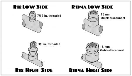

I bought a can of freeon and need to know where to put it in. I did it on my 1990 voyager and it worked great. Just don't know where the spot is on this car

You're looking for the 13mm fitting its in between the compressor and evaporator-see below
https://images.2carpros.com/forum/automotive_pictures/12900_ac_service_fittings_35.jpg
