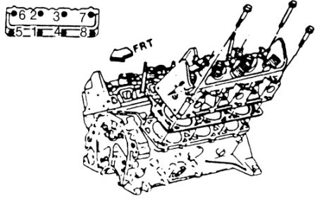

Looking for head bolt torque specs for a 3.1L engine.

Using the correct sequence, tighten the head bolts to 33 ft. lbs. (45Nm). After all bolts are tighten to 33 ft. lbs., rotate the torque wrench another 90 deg. or 1/4 turn. This will apply the correct torque to the head bolts.
Head bolt sequence
https://www.2carpros.com/forum/automotive_pictures/103836_torqu_seguance_1.jpg
