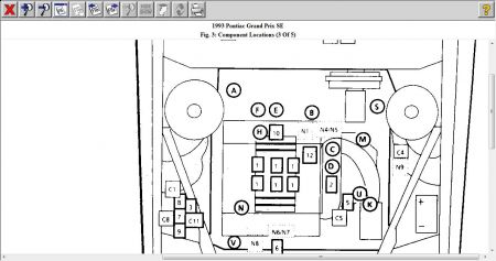

where is the speed sensor located on this car?
we can not find it on the front wheels or the rear wheels where our clinton book says it is.

Its on right rear of engine on transaxle The VSS is located at A see below
https://images.2carpros.com/forum/automotive_pictures/12900_vss_15.jpg
