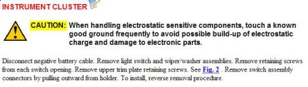

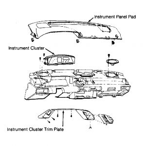

how do I remove the inst. Cluster to replace burnt out bulbs

FIG. 2
