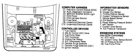

I need to replace the cooling fan switch, which I purchased from autozone whose website says it is located on the bottom passenger side of the radiator, but it isn't there. Is it possibly located elsewhere on some models?

For the 1990 2.3L engine it is on the right side of the engine, below the coolant outlet.
https://www.2carpros.com/forum/automotive_pictures/261618_Noname_2435.jpg
