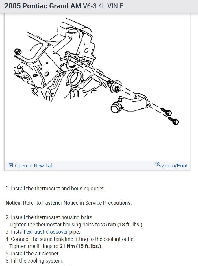

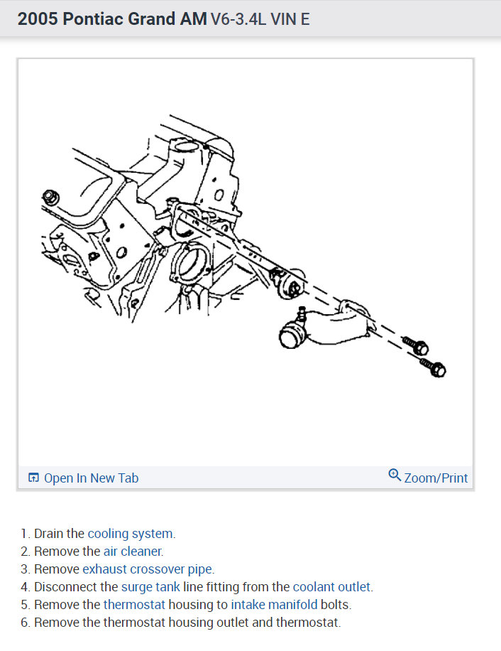

Where is the thermostat located and how do I replace it? The car overheats and jerks when I try to drive it HELP
Sunday, April 5th, 2009 AT 8:54 PM
18 Replies
BLUELIGHTNIN6
  • 16,542 POSTS
Here is a guide to help you step by step with instructions in the diagrams below to show you how on your car.

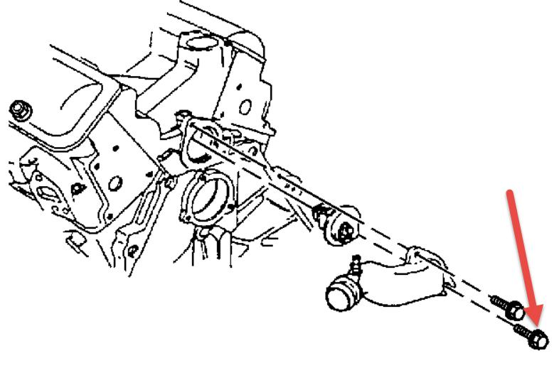

How do I get into the thermostat housing to change my thermostat
Wednesday, December 9th, 2020 AT 11:20 AM (Merged)
HMAC300
  • 48,601 POSTS
If air cleaner duct work in the way remove it. Then remove two bolts from housing an dcleand surfaces then reverse procedure for install. The bottom bolt in pic ned only be loosened until you can remove by hand, use a universal socket. 13mm

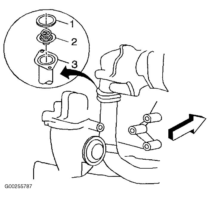

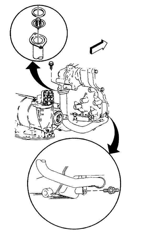

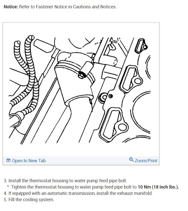

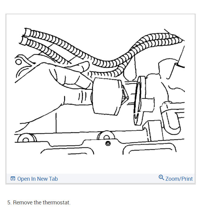

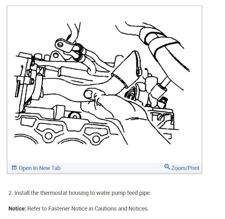

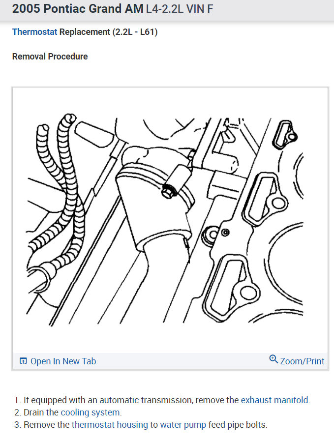

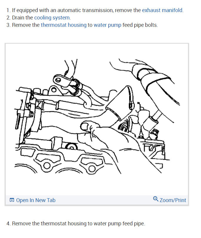

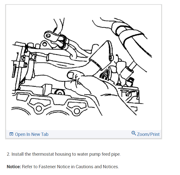

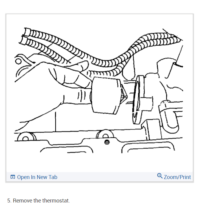

Putting in a new thermostat where is it located?
Wednesday, December 9th, 2020 AT 11:21 AM (Merged)
HMAC300
  • 48,601 POSTS
See pictures, you have to go through the wheel well to reach it.

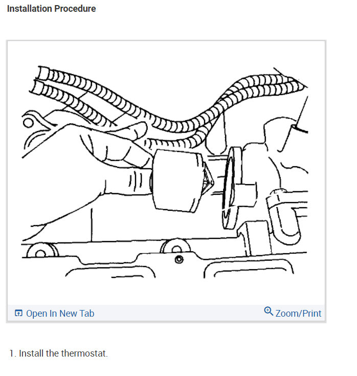

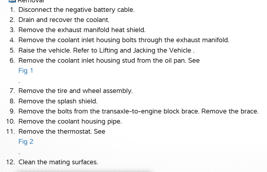

Location of t-stat on 2.4, upper or lower water inlet hose?
Please give specific details, thank you
KEN L
  • MASTER CERTIFIED MECHANIC
  • 55,488 POSTS
The thermostat is located on the tube headed to the water pump. Here is a guide and a diagrams (Below) of how to do the job
Here is your car (below)
