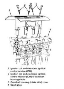

Where exactly on my car would they be & how do I change them? Help!

Here is a guide to help you step by step with instructions in the diagrams below to show you how on your car.
https://www.2carpros.com/articles/how-to-change-spark-plugs
SPARK PLUG REPLACEMENT
REMOVAL PROCEDURE
*NOTE: This engine has aluminum cylinder heads. Do not remove the spark plugs from a hot engine, allow it to cool first. Removing the spark plugs from a hot engine may cause spark plug thread damage or cylinder head damage.

1.Remove the ignition coil housing.
2.Remove the spark plugs with a spark plug socket. IMPORTANT: Remove any water and debris from the spark plug holes before spark plug removal with compressed air.
3.Inspect the spark plugs.

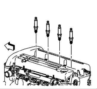

INSTALLATION PROCEDURE
https://www.2carpros.com/forum/automotive_pictures/12900_sparkplug2_1.jpg
1.Gap the spark plug, using round wire type spark plug gap gage. Adjust the spark plug gap to 1.14 mm (0.045 in) .
2.Install the spark plugs with a spark plug socket. IMPORTANT: DO NOT coat the spark plugs with anti seize compound. Over torquing could occur and damage to the cylinder head threads may result. NOTE: Refer to Fastener Notice in Service Precautions. Tighten the spark plugs to 20 N.m (15 lb ft) .
3.Install the ignition coil housing.
