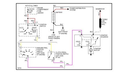

  • 75,992 POSTS
You need to check for power on the purple wire while key at cranking position-no power could mean transmission range switch and ignition switch
+1

WRENCHTECH
  • 20,761 POSTS
There is no starter relay in this circuit.
Saturday, August 1st, 2020 AT 11:24 AM (Merged)
JDL
  • 16,098 POSTS
You don't have one. There is a solenoid on top of the starter. The starter solenoid S terminal, should be hot with the key in the crank position. That circuit is wired through the clutch switch. Any testing make sure the tranny is out of gear and the e-brake is set.

BIGKAHONA29
  • 1996 PONTIAC GRAND AM
  • 4 CYL
  • FWD
  • 100,000 MILES
I was wondering where the stater relay is located on this car. I cant find the part online. I ve replaced the starter and battery. Car was running fine when I parked it. Came out a week later to start nothing. When I turn the ignition on everything lights up and when I turn the key all the way the headlamps go out and then when I let go of the ignition they turn back on. Someone had mentioned a ignition switch. If so what does that involve to do. Im a decent mechanic so no need to put things in simple terms.
Thanks KEVIN
  • 75,992 POSTS
You don't have a starter relay-could be the ignition switch or the Park and Neutral position switch. See below
https://www.2carpros.com/forum/automotive_pictures/12900_starter_14.jpg
