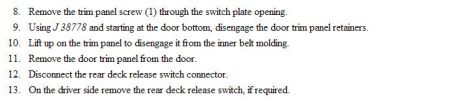

My driver side window seems to be off the track, could you please tell me the way to get the inside panel off so I can fix it. The window motor works but the window just drops to the bottom and then I have to help it up any and all help is welcomed Thank you Mike

https://www.2carpros.com/forum/automotive_pictures/261618_Noname_1526.jpg
https://www.2carpros.com/forum/automotive_pictures/261618_Noname2_458.jpg
