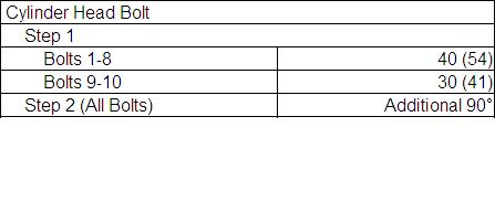

i need head torque specs for 2.4 liter

Welcome, the first numbers in the right hand column are foot lbs.
