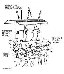

There are no plug wires on a quad 4 engine do you know of a way to check spark

http://www.2carpros.com/forum/automotive_pictures/12900_quad4_1.jpg
disconnect the square electric connector on the side of the module
remove four screws pull the assembly and set aside
plug back in the module
and crank
check for spark
