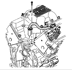

How do I change the cam shaft sensor?
Friday, January 23rd, 2009 AT 9:43 PM
3 Replies
BLUELIGHTNIN6
  • 16,542 POSTS
Locate sensor at front of engine (pictured below).
Usually there is an electrical connecter and a few bolts that hold it in place. Simply disconnect and remove for replacement.
https://www.2carpros.com/forum/automotive_pictures/261618_Noname_65.jpg

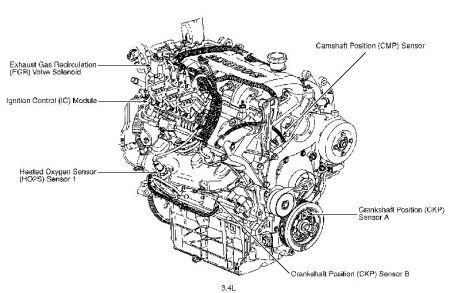

Camshaft sensor location and installation
Monday, June 14th, 2021 AT 10:33 AM (Merged)
  • 75,992 POSTS
REMOVE OR DISCONNECT
Disconnect the negative battery cable.
Remove the serpentine drive belt.
Remove power steering pump assembly.
Remove the electrical connector.
Remove the bolt.
Remove the sensor.
