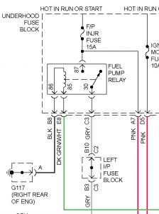

I need to know if my 2001 Grand Am fuel pump has a reset switch. Unable to get the car crank since running out of gas. Add $10 worth of gas into tank. The car is acting like it is still out of gas. I do not hear a humming sound for the fuel pump. Perform the spark plug test and it fires, purchse a new battery 6 months ago. Please help!

I believe there is a fuse and a relay. Maybe you didn't run out of gas, maybe it quit pumping. There is no reset button.

Where is the fuse located and what relay? Where is the relay located? Are you talking about the fuel pump relay switch?

There is no reset.
Under the hood there is a box.
Relay:
https://www.2carpros.com/forum/automotive_pictures/30961_fuse_2.jpg
https://www.2carpros.com/forum/automotive_pictures/30961_fude_1.jpg
Fuse:
https://www.2carpros.com/forum/automotive_pictures/30961_fu2_1.jpg
https://www.2carpros.com/forum/automotive_pictures/30961_fu1_1.jpg
https://www.2carpros.com/forum/automotive_pictures/30961_mitchel_33.jpg
