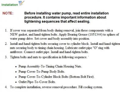

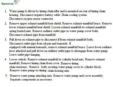

My grand am's water pump is driven by the timing chain and i'm wondering what I need to do to replace.
