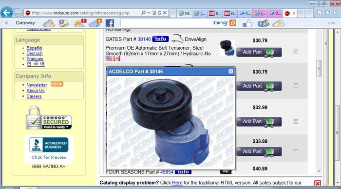

SATURNTECH9
  • CAR REPAIR CONTRIBUTOR
  • 30,869 POSTS
Idler pulley with spring?The idler pulley shouldn't have a spring.Are you talking about the belt tenisor?if so did the bolt break that holds the pulley on?
Jul 28, 2020 at 1:08 PM (Merged)
SATURNTECH9
  • 30,869 POSTS
Does it look like the one i posted?
FUNNYF
  • 17 POSTS
Yes, that looks like it.. the main bolt that holds tenisor onto motor broke, not the bolt that just holds pully onto the spring tenisor. HOW DO I GET TO IT to get broken threaded thats broke off in block? thank you!
