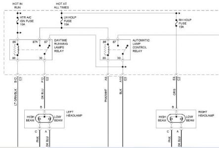

My high beam headlight is on when the lights turn on at night. the high beams work when i use them. the fog lights not working. service light does come on if i have the switch in one position, not sure if its on low or high beam.I had to replace the headlight socket now i am wondering if I rewired them wrong. I have 2 blue and 1 red on drivers side and a orange, red and blue on passenger side. do you have a diagram to hook up wires to new socket?

Welcome to the forum, my info showed this. Thanks for the donation.
https://images.2carpros.com/forum/automotive_pictures/170934_grand_am_headlamp_wiring_1.jpg
