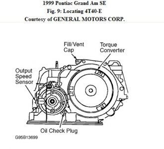

Not finding location of dip stick for tranny.

You can't find it because there isn't one. there is a check plug that has to be removed to see if it's at the right level. Make sure the car is level, here is picture of placement. it's on the passenger side.
