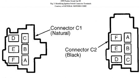

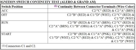

Turn ignition off. Disconnect ignition switch 6-pin connectors C1 and C2. See Fig. 2 . Using DVOM, check for continuity between specified terminals with ignition switch in specified position. See IGNITION SWITCH CONTINUITY TEST (CAVALIER & SUNFIRE) table or IGNITION SWITCH CONTINUITY TEST (ALERO & GRAND AM) . If continuity does not exist as indicated, repair as necessary.

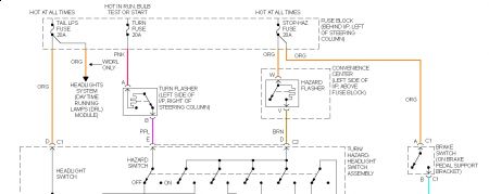

JDL
  • 16,098 POSTS
Hi, any fuses you checked, did you use a testlite on the fuse circuit? Even if the fuse is good, if no voltage, the circuit is dead. Usually the problem is the multifunction switch in the steering column, it doesn't hurt to check voltage.

INTERNETMECHANIC
  • 700 POSTS
Any fuses you check, you need to check for voltage on the fuse circuit. Even if the fuse is good, if there is no voltage the circuit is dead. The fuse usually has a bare spot over each leg, you don't have to pull the fuse. The circuit goes hot with the key on, if both bare spots are hot, the turn fuse is good and the circuit has voltage. Use a voltage tester. I believe there is more than one flasher and I don't know which one you replaced? If everything checks out and the emergency lites flash and brake lites work. Check the multifunction switch.
