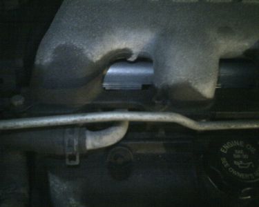

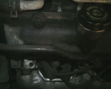

1999 grand am 3.4L I keep refilling the cooling system after about a day or two of driving. I changed the oil and noticed that it came out a bit orange due to the dex-cool leaking into the oil. And lately after I drive the car for about half an hour, i could see vapor comming out of the hood. It is wet around the intake manifold since i believe the vapors are comming out of there. The "low coolant" light hasn't come out but i believe that this leak is due to bad intake manifold gaskets. Could this be it or could it be something else?

Intake gasket is the very common failure
causing coolant leak
it should be corrected and fix as soon as possible
