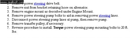

How do I remove the power steering pump and replace it.
Wednesday, December 19th, 2007 AT 10:29 AM
BMRFIXIT
MECHANIC
19,053 POSTS
Hope that help
let me know if need more
