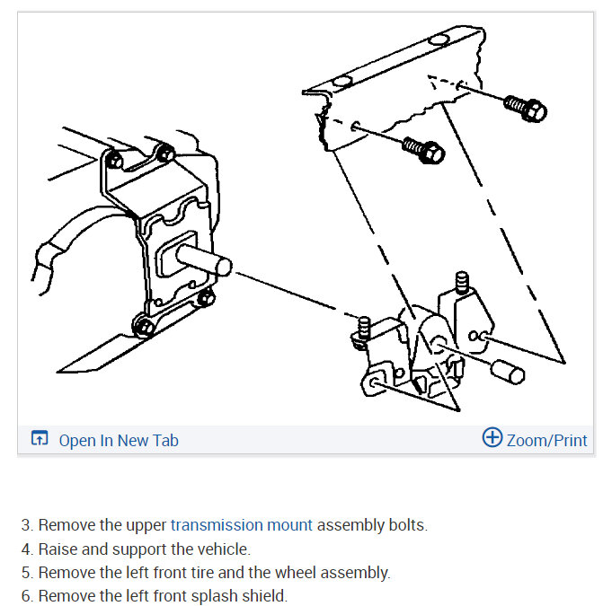

1997 Pontiac Grand Am V6 Front Wheel Drive Automatic 160000 miles
How do you replace the transmission mount

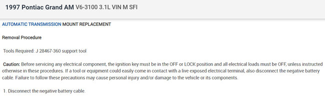

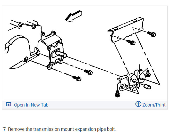

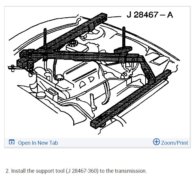

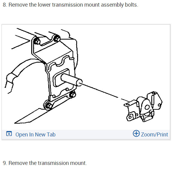

Sure here are the instructions on how to change out the transmission mount, let me know if you need anything else. Check out the images (below). Please let us know what happens.
