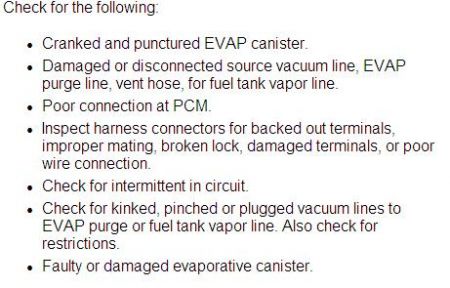

There is a code p0440 you have any idea what it is thank you
Wednesday, February 24th, 2010 AT 4:12 PM
JDL
  • 16,098 POSTS
The code has to do with your evap system.
https://www.2carpros.com/forum/automotive_pictures/170934_evap_system_1.jpg
Thursday, February 25th, 2010 AT 9:42 AM
