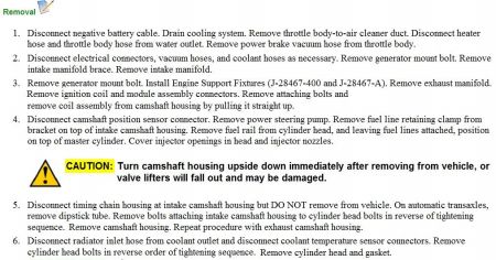

Im down to the head but I can't get it out and I took the timing cover off and that it
