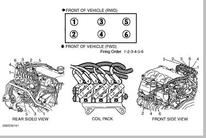

WHAT IF WE TOOK ALL THE WIRES OFF AT THE SAME TIME HOW DO WE GO ABOUT PUTTING ON THE RIGHT WAY

Hi, found this for grand am GT. Numder one on the coil goes to number 1 cylinder.
