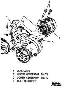

how do I replace the alternator

Alternator removal:
https://www.2carpros.com/forum/automotive_pictures/12900_alty_67.jpg
REMOVE OR DISCONNECT
Negative battery cable at battery.
Serpentine belt.
CAUTION: To avoid personal Injury when rotating the serpentine belt tensioned on 2.4L use a tight fulfilling 13 mm wrench that Is at least 61 cm (24") long. This operation can be done using tool J 37059 or equivalent.
Generator mounting stud and bolts.
Generator electrical connections.
Generator assembly.
INSTALL OR CONNECT
Generator assembly.
Serpentine belt.
Negative battery cable.
