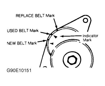

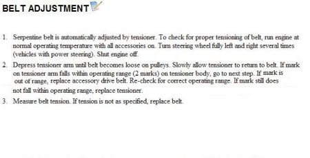

I recently replaced my tensioner and belt and when I went to put the belt on the tensioner isnt springing back like it should. The belt is also hitting off the lower motor mount what is the problem? Any suggestions?

Okay, first lets just make sure you have the correct belt routing..
https://images.2carpros.com/forum/automotive_pictures/261618_Graphic_65.jpg
If this is OK, try adjusting the belt.
https://images.2carpros.com/forum/automotive_pictures/261618_Noname_638.jpg
https://images.2carpros.com/forum/automotive_pictures/261618_2_52.jpg
Jul 3, 2009 at 3:33 PM
BICKERSRON
  • 8 POSTS
Thanks man that helped tried to give u some positive feedback but it wont let me.
