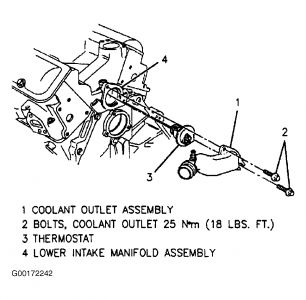

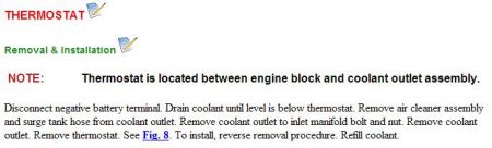

I am in the middle of trying to change the thermostat in my kids 94 Grand Am, I have drained the anti freeze and removed the air cleaner housing to get a better look and more access to the two bolts to get to the thermostat. But have very little room to loosen them. How much more equipent needs to be removed to finish the job ?

https://images.2carpros.com/forum/automotive_pictures/261618_Noname_598.jpg
FIGURE 8
https://images.2carpros.com/forum/automotive_pictures/261618_8_1.jpg
