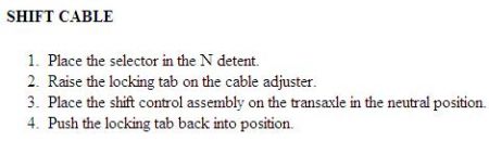

I need to find out what the forward and backward cable for the shifter is called.

Are you talking about the shift cable?
that is part of the adjust procedure.
