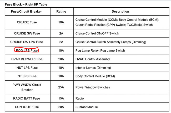

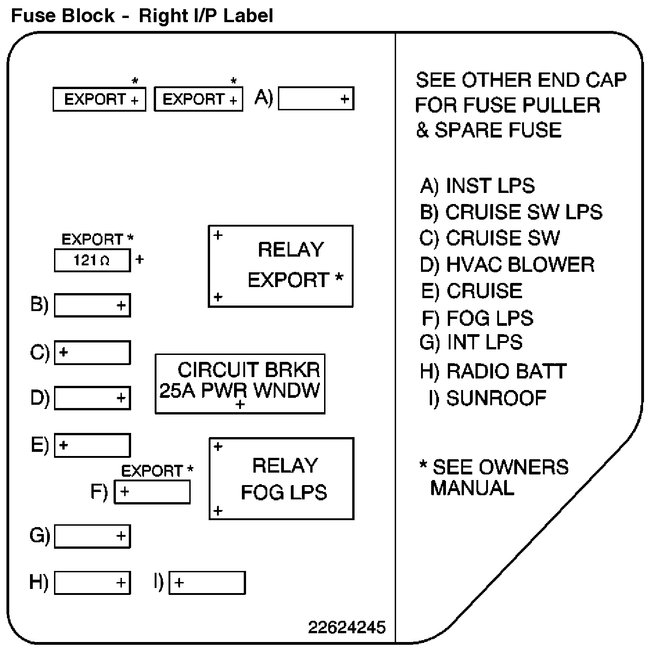

Where is the fuse for the fog lights on a, 2003 Pontiac grand am?
Jun 5, 2020 at 6:51 PM
  • CAR REPAIR CONTRIBUTOR
  • 110,190 POSTS
The fuse is in the right hand instrument panel fuse box. See the pics below.
